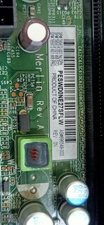

after i flash this bios mac address became ff:ff:ff:ff and ehther not workingBios - hp prodesk 600 g1 small form factor bio-ver-00.02.75 rev.a bios

after 5 second restart and start after 5 second restartwhat was problem with old bios ?
Reputation:
if bios works normal and only problem is internet then i think problem is not from biosafter 5 second restart and start after 5 second restart
but last file working normally but no internet
reputation_scoree
ok i will tryif bios works normal and only problem is internet then i think problem is not from bios
try new windows or drive
