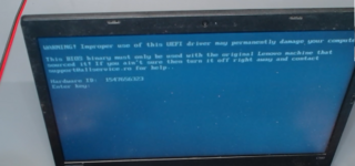

1411622473So after pressing F1 and entering password 1234 I get this message but the laptop doesn't stay on after displaying the message, shuts down after 3 seconds and the hardware ID gets reset a new one will appear after retrying. All of this without any battery as motioned in the instructions. I don't have the original charger I have the laptop plugged with an USB C + and - to the power supply. If I plug the battery still the same (no bios battery plugged). Any idea why?

Thank you! Works now.[ HOW TO USE THE PATCH ]
STEP 1: Flash and replace current BIOS with the generated patch file
STEP 2: Boot the machine
STEP 3: Press ENTER/F1/etc. to enter BIOS settings
STEP 4: Enter any character when asked for Supervisor Password
STEP 5: Press enter when it shows Hardware ID
STEP 6: Press space bar 2x when asked
STEP 7: Turn off machine
STEP 8: Restore original BIOS
STEP 9: Reset BIOS settings to factory default
